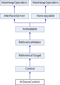

+ Inheritance diagram for IKSlaveControl:
