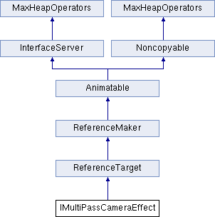

+ Inheritance diagram for IMultiPassCameraEffect:
