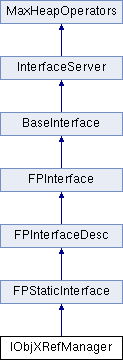

+ Inheritance diagram for IObjXRefManager:
