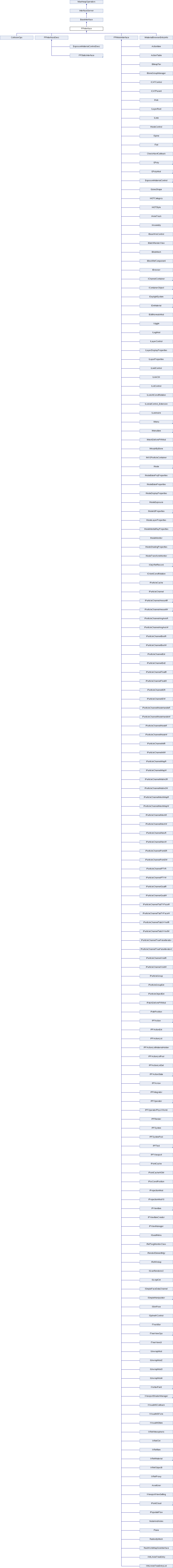

The Function Publishing system makes use of this class. Functions are published in one or more Interfaces by a plug-in. Each interface is represented by an instance of a class derived from this base class.
Note that the Function Publishing class hierarchy is as follows:
FPInterface: This is the base class for all interfaces, the prime client type for using interfaces.
FPInterfaceDesc: This is the class which contains interface metadata.
FPStaticInterface: This is the class to use as the base class for defining static or core virtual interface classes.
FPMixinInterface: This is for use as the base class for defining object-based mixin interface classes, in this case you also use FPInterfaceDesc for mixin interface descriptors.
+ Inheritance diagram for FPInterface:
