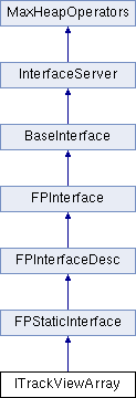

+ Inheritance diagram for ITrackViewArray:
