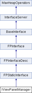

+ Inheritance diagram for IViewPanelManager:
