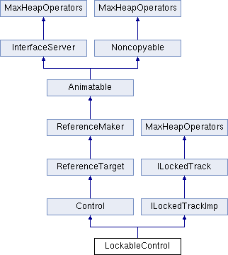

LockableControl Class Reference
#include <ILockedTracks.h>
Class Description
See also
Class Control, Class ILockedTrackImp.
This class represents the combination of a Control class with the ILockedTrackImp class. You can use this class to implement locked track functionality over a Control class.
+ Inheritance diagram for LockableControl:
