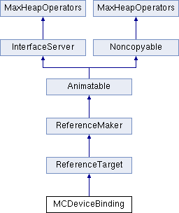

MCDeviceBinding Class Reference
MCDeviceBinding Class Referenceabstract
#include <mcapdev.h>
Class Description
See also
Class ReferenceTarget, Class MCInputDevice, Class IMCParamDlg, Class IRollupWindow.
Description:
An instance of this class is created when a motion capture controller binds one of its parameters to a device. The main purpose of this class is to store any parameters that describe the binding.
+ Inheritance diagram for MCDeviceBinding:
