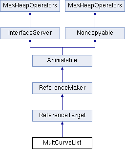

+ Inheritance diagram for MultCurveList:
