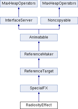

+ Inheritance diagram for RadiosityEffect:
