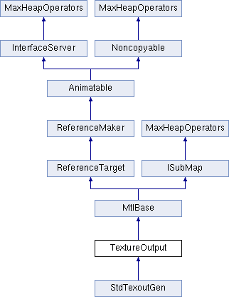

+ Inheritance diagram for TextureOutput:
