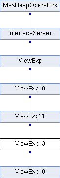

Class Description
Extends ViewExp11.

+ Inheritance diagram for ViewExp13:
