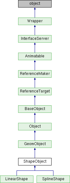

An open or closed hierarchical shape made up of one or more parts such as bezier splines or poly lines.
| def | AttachShape (self, args) |
| def | CanMakeBezier (self) |
| def | CopyBaseData (self, args) |
| def | CurveClosed (self, args) |
| def | GenerateMesh (self, args) |
| def | GetAngle (self, args) |
| def | GetDispRenderMesh (self) |
| def | GetGenUVs (self) |
| def | GetLengthOfCurve (self, args) |
| def | GetMatID (self, args) |
| def | GetNumberOfCurves (self, args) |
| def | GetNumberOfPieces (self, args) |
| def | GetNumberOfVertices (self, args) |
| def | GetObjectDisplayRequirement (self) |
| def | GetRenderable (self) |
| def | GetShapeObjValidity (self, args) |
| def | GetSides (self, args) |
| def | GetThickness (self, args) |
| def | GetUsePhysicalScaleUVs (self) |
| def | GetUseViewport (self) |
| def | GetViewportAngle (self) |
| def | GetViewportOrRenderer (self) |
| def | GetViewportSides (self) |
| def | GetViewportThickness (self) |
| def | InterpCurve3D (self, args) |
| def | InterpPiece3D (self, args) |
| def | MakeBezier (self, args) |
| def | MakePolyShape (self, args) |
| def | PrepareDisplay (self, args) |
| def | SetAngle (self, args) |
| def | SetDispRenderMesh (self, args) |
| def | SetGenUVs (self, args) |
| def | SetRenderable (self, args) |
| def | SetSides (self, args) |
| def | SetThickness (self, args) |
| def | SetUsePhysicalScaleUVs (self, args) |
| def | SetUseViewport (self, args) |
| def | SetViewportAngle (self, args) |
| def | SetViewportOrRenderer (self, args) |
| def | SetViewportSides (self, args) |
| def | SetViewportThickness (self, args) |
| def | TangentCurve3D (self, args) |
| def | TangentPiece3D (self, args) |
| def | UpdatePerNodeItems (self, args) |
| def | UpdatePerViewItems (self, args) |
| def | CanDoDisplacementMapping (self) |
| def | IsInstanceDependent (self) |
| def | NumberOfRenderMeshes (self) |
| def | ApplyUVWMap (self, args) |
| def | AsParticleObject (self, args) |
| def | AsShapeObject (self, args) |
| def | AsSplineShape (self, args) |
| def | AsTriObject (self, args) |
| def | BranchDeleted (self, args) |
| def | CanCacheObject (self) |
| def | CanConvertToType (self, args) |
| def | CheckObjectIntegrity (self) |
| def | CollapseObject (self) |
| def | ContainedShapeSelectionArray (self) |
| def | ConvertToDerivedObject (self) |
| def | ConvertToType (self, args) |
| def | CopyAdditionalChannels (self, args) |
| def | CopyChannelLocks (self, args) |
| def | DeleteAllAdditionalChannels (self) |
| def | DoOwnSelectHilite (self) |
| def | Eval (self, args) |
| def | FindBaseObject (self) |
| def | FreeChannels (self, args) |
| def | GetBranchINode (self, args) |
| def | GetChannelLocks (self, args) |
| def | GetChannelValidity (self, args) |
| def | GetContainedShape (self, args) |
| def | GetContainedShapeMatrix (self, args) |
| def | GetDeformBBox (self, args) |
| def | GetExtendedProperties (self, args) |
| def | GetNoEvalInterval (self) |
| def | GetNumContainedShapes (self) |
| def | GetNumFaces (self, args) |
| def | GetNumMapChannels (self) |
| def | GetNumMapsUsed (self) |
| def | GetNumPipeBranches |
| def | GetNumPoints (self) |
| def | GetNumSurfaces (self, args) |
| def | GetNumVerts (self, args) |
| def | GetObjectValidity (self, args) |
| def | GetPipeBranch (self, args) |
| def | GetPoint (self, args) |
| def | GetSubselState (self) |
| def | GetSurfacePoint (self, args) |
| def | GetWeight (self, args) |
| def | GetWorldSpaceObjectNode (self) |
| def | HasWeights (self) |
| def | InitNodeName (self, args) |
| def | IntersectRay (self, args) |
| def | InvalidateChannels (self, args) |
| def | IsBaseClassOwnedChannel (self, args) |
| def | IsDeformable (self) |
| def | IsManipulator (self) |
| def | IsMappable (self) |
| def | IsObjectLocked (self) |
| def | IsParamSurface (self) |
| def | IsParticleSystem (self) |
| def | IsPointSelected (self, args) |
| def | IsRenderable (self) |
| def | IsShapeObject (self) |
| def | IsWorldSpaceObject (self) |
| def | LockChannels (self, args) |
| def | LockObject (self) |
| def | MakeShallowCopy (self, args) |
| def | MergeAdditionalChannels (self, args) |
| def | NewAndCopyChannels (self, args) |
| def | NormalAlignVector (self, args) |
| def | PointSelection (self, args) |
| def | PointsWereChanged (self) |
| def | PreferredCollapseType (self) |
| def | ReadyChannelsForMod (self, args) |
| def | ReduceCaches (self, args) |
| def | SetChannelLocks (self, args) |
| def | SetChannelValidity (self, args) |
| def | SetNoEvalInterval (self, args) |
| def | SetPoint (self, args) |
| def | SetSubSelState (self, args) |
| def | SetWeight (self, args) |
| def | ShallowCopy (self, args) |
| def | SurfaceClosedU (self, args) |
| def | SurfaceClosedV (self, args) |
| def | TopologyChanged (self) |
| def | UnlockChannels (self, args) |
| def | UnlockObject (self) |
| def | UpdateValidity (self, args) |
| def | UseSelectionBrackets (self) |
| def | UsesWireColor (self) |
| def | WSStateInvalidate (self) |
| def | ActivateSubSelSet (self, args) |
| def | ChangeTopology (self) |
| def | ClearSelection (self, args) |
| def | ForceNotify (self, args) |
| def | GetLocalBoundBox (self, args) |
| def | GetNamedSelSetName (self, args) |
| def | GetNumNamedSelSets (self) |
| def | GetNumSubObjTypes (self) |
| def | GetObjectName (self) |
| def | GetSubObjectLevel (self) |
| def | GetSubObjType (self, args) |
| def | GetSubObjTypeName (self, args) |
| def | GetWorldBoundBox (self, args) |
| def | HasUVW (self, args) |
| def | HasViewDependentBoundingBox (self) |
| def | HitTest (self, args) |
| def | InvertSelection (self, args) |
| def | Move (self, args) |
| def | NewSetFromCurSel (self, args) |
| def | OKToChangeTopology (self, args) |
| def | RemoveSubSelSet (self, args) |
| def | Rotate (self, args) |
| def | Scale (self, args) |
| def | SelectAll (self, args) |
| def | SetGenUVW (self, args) |
| def | SetNamedSelSetName (self, args) |
| def | SetupNamedSelDropDown (self) |
| def | SupportsNamedSubSels (self) |
| def | TransformCancel (self, args) |
| def | TransformFinish (self, args) |
| def | TransformHoldingFinish (self, args) |
| def | TransformHoldingStart (self, args) |
| def | TransformStart (self, args) |
| def | FindDependentNode (self) |
| def | NotifyTarget (self, args) |
| def | ClearFlagInHierarchy (self, args) |
| def | DeleteMe (self) |
| def | DeleteReference (self, args) |
| def | FindRef (self, args) |
| def | GetNumRefs (self) |
| def | GetReference (self, args) |
| def | NotifyChanged (self) |
| def | NotifyDependents (self, args) |
| def | ReplaceReference (self, args) |
| def | RescaleWorldUnits (self, args) |
| def | AddNewKey (self, args) |
| def | AssignController (self, args) |
| def | CanAssignController (self, args) |
| def | CanCopyAnim (self) |
| def | CanCopyTrack (self, args) |
| def | CanDeleteSubAnim (self, args) |
| def | CanMakeUnique (self) |
| def | ClearAFlag (self, args) |
| def | ClearAFlagEx (self, args) |
| def | ClearAllAppData (self) |
| def | ClearFlagBit (self, args) |
| def | ClearFlagInAllAnimatables (args) |
| def | CopyKeysFromTime (self, args) |
| def | DeleteAppData (self, args) |
| def | DeleteKeyAtTime (self, args) |
| def | DeleteKeyByIndex (self, args) |
| def | DeleteKeys (self, args) |
| def | DeleteSubAnim (self, args) |
| def | DeleteTime (self, args) |
| def | DoesSupportTimeOperations (self) |
| def | EditTimeRange (self, args) |
| def | FreeCaches (self) |
| def | GetAnimByHandle (args) |
| def | GetAnimHandle (self) |
| def | GetAppData (self, args) |
| def | GetClassID (self) |
| def | GetClassName (self) |
| def | GetCustomAttributeContainer (self) |
| def | GetHasSubElements |
| def | GetKeyIndex (self, args) |
| def | GetKeyTime (self, args) |
| def | GetNextKeyTime (self, args) |
| def | GetNodeName (self) |
| def | GetNumKeys (self) |
| def | GetNumSubAnims (self) |
| def | GetParameterBlock (self) |
| def | GetSubAnim (self, args) |
| def | GetSubAnimName (self, args) |
| def | GetSuperClassID (self) |
| def | GetTimeRange (self, args) |
| def | InsertTime (self, args) |
| def | IsAnimated (self) |
| def | IsKeyAtTime (self, args) |
| def | IsSubClassOf (self, args) |
| def | MoveKeys (self, args) |
| def | ReverseTime (self, args) |
| def | ScaleKeyValues (self, args) |
| def | ScaleTime (self, args) |
| def | SetAFlag (self, args) |
| def | SetAFlagEx (self, args) |
| def | SetAppData (self, args) |
| def | SetFlagBit (self, args) |
| def | SubNumToRefNum (self, args) |
| def | TestAFlag (self, args) |
| def | TestAFlagEx (self, args) |
| def | TestFlagBit (self, args) |
| def | GetInterface (self, args) |
| def | GetUnwrappedPtr (self) |
tuple | thisown = _swig_property(lambda x: x.this.own(), lambda x, v: x.this.own(v), doc='The membership flag') |
tuple | NumRefs = _swig_property(GetNumRefs) |
tuple | Refs = _swig_property(lambda self: (self.GetReference(i) for i in xrange(self.GetNumRefs()))) |
tuple | AnimHandle = _swig_property(GetAnimHandle) |
tuple | ClassID = _swig_property(GetClassID) |
tuple | ClearFlagInAllAnimatables = staticmethod(ClearFlagInAllAnimatables) |
tuple | GetAnimByHandle = staticmethod(GetAnimByHandle) |
tuple | KeyTimes = _swig_property(lambda self: (self.GetKeyTime(i) for i in xrange(self.GetNumKeys()))) |
tuple | NodeName = _swig_property(GetNodeName) |
tuple | NumSubAnims = _swig_property(GetNumSubAnims) |
tuple | ParameterBlock = _swig_property(GetParameterBlock) |
tuple | SubAnimNames = _swig_property(lambda self: (self.GetSubAnimName(i) for i in xrange(self.GetNumSubAnims()))) |
tuple | SubAnims = _swig_property(lambda self: (self.GetSubAnim(i) for i in xrange(self.GetNumSubAnims()))) |
tuple | SuperClassID = _swig_property(GetSuperClassID) |
