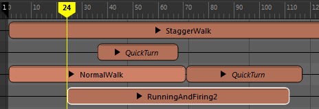

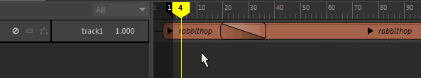

After you create a Animation Source, and bring it into the Time Editor, it becomes a clip on a track. A clip, which is the animation building block of the Time Editor, is an instance of the source. This lets you create unlimited clips from a single Animation Source. When you modify a clip, the Animation Source is not changed. However, if you modify the Animation Source, every clip that refers to it is affected.
Important: When an Animation Source is being reused elsewhere in the Time Editor, all instances of its title are italicized. This is to help you avoid modifying the clip if you modify an Animation Source clip in a composition. Be careful not to open the Graph Editor and move a key on the animation, or you will change the source animation.
To create a version of an Animation Source so you can make edits to, right-click the clip and Make Animation Source Unique from the Time Editor clip contextual menu. This lets you make the selected Animation Source independent from its originating clip.
Think of clips as containers that hold animation or audio on a track. You can have multiple clips on a track but they must be all the same track type, that is, animation or audio. See Time Editor Clip contextual menu for a list of operations you can perform when you right-click a clip in the Time View.

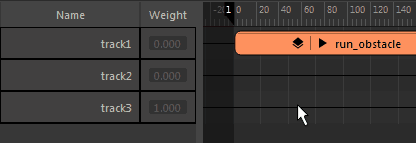

Clip Layers
You can create layers on Time Editor clips, so you can modify the existing clip animation. See Add Clip Layers to the Time Editor and Animate on layer clips. They behave similarly to Maya Animation Layers but are exclusive to Time Editor clips because you cannot drive Time Editor animation with both Animation Layers and Clip Layers as this creates conflicts.
Layer clips have a Clip Layer icon next to the name. Click this to expand the Layer view.

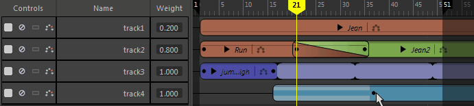

A Group clip is clip made up of many clips packaged together to which you can apply edit functions. Shift- or drag-select to grab clips, and click Create Group icon on the Time Editor toolbar or select Clip > Group from the Time Editor menu bar.
Click the arrow on the Group clip to view the contents. For how to create a Group clip, see Combine clips into Group clips.
You can import FBX files with multiple takes into one Group clip. See Import Multiple Takes in the Time Editor.
Note: Grouping a clip does not mean that you no longer have access to the clips inside the Group. See Edit Clips inside a Group.
Once you create a Group clip, you can move, scale, copy, loop, and create transitions for it. The position and any transitions, clip effects, etc. you applied to the individual clips inside the Group remain intact.
