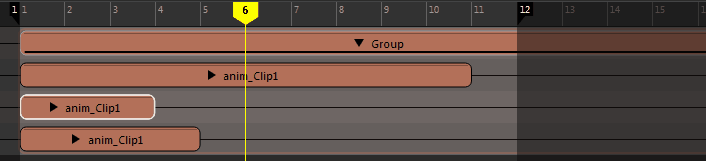

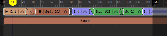

- Clip Edge Edit Mode
- Activate the following nodes to perform the following actions interactively.
Trim
- Lets you set the in and out points of a clip so that only part of the original source contributes to the clip. Select
Trim from the
Edit Mode menu, and place your cursor at the left or right edge of a clip. Notice the change in cursor look. Drag the cursor to trim.
A negative number on top of the clip indicates the number of frames trimmed.
A white dot on a child clip indicates that it is trimmed because of the parent clip. The white dot does not appear if a child clip is too small to display.
A black dot on the trimmed clip indicates that there is animation outside the clip.
See
Time Editor Clip symbols for more.
Tip: Trim mode is the default Edit mode for the Time Editor. You can also press
E with a clip selected to activate Trim mode.

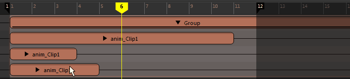

Scale
- Lets you speed up or slow down the clip's animation. Select
Scale from the
Edit Mode menu, and place your cursor to the left or right edge of a clip. Notice the change in cursor look. Drag the cursor to scale.
The scale percentage appears at the top of the clip.

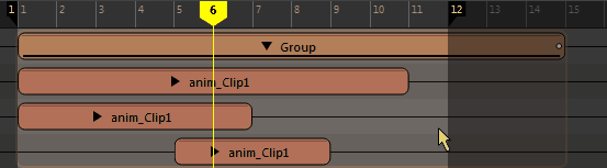

Loop
- Lets you repeat a clip's animation multiple times sequentially. Select
Loop from the
Edit Mode menu, place your cursor at the left or right edge of a clip, and drag to loop.
To adjust the looping, click and drag the edges of the looped area of the clip. A Loop After value (0.3 in the above figure) appears to indicate the number of loops the clip contains. If you loop the left side of the clip, then it is the Loop Before value. When you scale, trim, or loop a clip, the virtual border of a clip becomes the real border to perform all edit operations.
Tip: You can also press
T with a clip selected to activate Loop mode.
- You can set looping at clip
start and
end separately, with the
Clip Loop Before Mode/Clip Loop After Mode in the Attribute Editor. There you can find two types of Looping modes,
Cyclical, which makes the animation repeat itself, and
Progressive, which repeats animation with an offset so you can use it to create a walk cycle. For a description of these two looping methods, see
Types of Loops in the Time Editor.
Note: You cannot split a clip once a Hold or Looping has been applied to it. Make it into a
Group clip and split it instead.
Note: To use Animation layers with a looped clip, create a
Group clip from it, and then add layers to the Group.

- Bake
- Bake to New Clip/Bake to New Clip and Delete
- Merges the selected clip to a single clip, creating only the minimum number of keyframes necessary in the merged clip. Deletes the original animation, if specified.
- Once you have baked your clips, you can perform editing operations on it as if it were a single clip. See
Edit animation in the Time Editor.
Note: You can use
Bake to new Clip with Group clips or multiple selected clips.
- For more information about Baking clips, see
Bake Time Editor clips.
