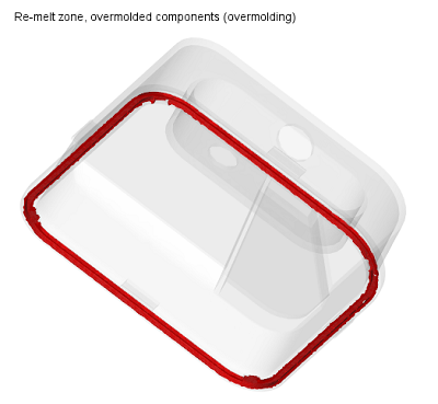

The figure above shows the
Re-melt zone plot, which is an important result from an overmolding analysis. You will review this result later.
