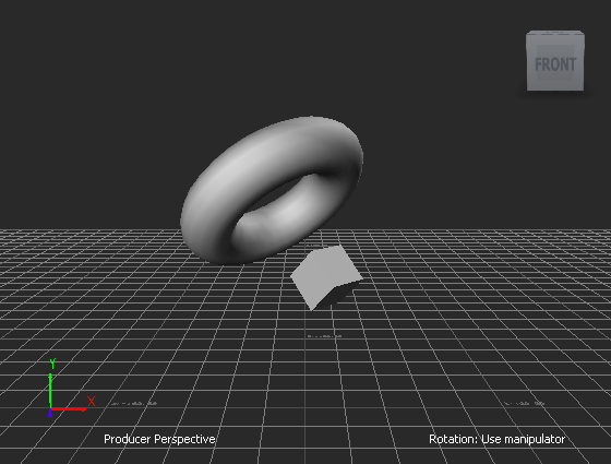

In the code sample below, a torus model is created, and parented to the cube created above. Any subsequent geometric transformations applied to the cube will also be applied to the torus.

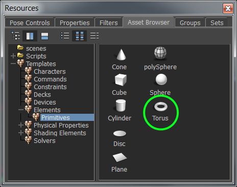

# Create a torus, and position it in space. torus = FBCreateObject( 'Browsing/Templates/Elements/Primitives', 'Torus', 'Torus' ) torus.Scaling = FBVector3d(5, 5, 5) # Set the torus' parent as the cube. Any local transformations # applied to the torus will now be in relation to the cube's frame # of reference. torus.Parent = cube # Translate the torus by 5 units above the cube. torus.Translation = FBVector3d(0, 5, 0) torus.Show = True # Rotate the cube by -45 degrees along its parent's x axis, # and by 45 degrees along its parent's y axis. # This will now also rotate the torus accordingly. cube.Rotation = FBVector3d(-45, 45, 0)
Program Summary: The program below creates a cube and a torus, and assigns the torus as a child to the cube. The printSceneGraph() helper function recursively traverses and prints the scene graph.
