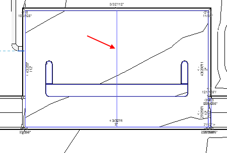

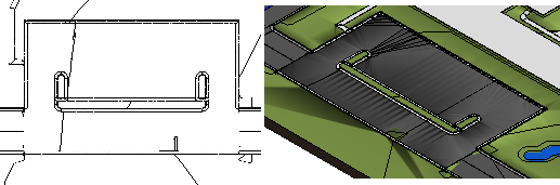

After creating a parking lot, use the Modify Parking Lot tool to access the Add Breakline tool. Use breaklines to create hard breaks on the parking lot surface to help you define high and low points, grading planes, and catch basin areas. You can add breaklines at a relative elevation from the current parking lot surface, at a constant elevation, or by grade.
