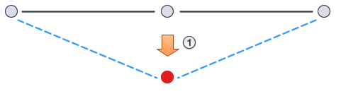

In the software, you select a point or vertex of the host line, and specify an elevation value, as described in the section "To change the elevation of a point" in Change Elevations for a Site Element.
Conceptually, you are changing the elevation of the selected point
, as shown in the following illustration.
Site Designer calculates and adjusts the slope from that point to adjacent points, indicated by the blue dashed lines.

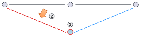

In the software, you select the midpoint between 2 vertices, enter a new slope value, and specify which endpoint of the line segment should move. This process is described in the section "To change the slope of a midpoint" in Change Elevations for a Site Element.
Conceptually, you are specifying a new slope value for a line
, and indicating which endpoint
of the line segment should move as a result of the change.
Site Designer calculates and adjusts the elevation of the moving endpoint, as shown in blue in the following illustration. It also adjusts slopes of surrounding areas accordingly.
