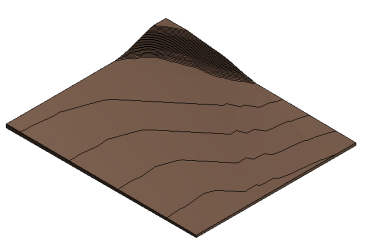

The toposurface is the basis of all work in Site Designer.
Before using Site Designer tools to create site elements, create (or import) a toposurface in the Revit model. Then use a Site Designer tool to create a copy of the original toposurface. This copy becomes the proposed toposurface, the one that Site Designer manipulates.
The original toposurface remains in the Revit model with its Phase Created property set to Existing. The proposed toposurface has its Phase Created property set to New Construction. To control which toposurface is displayed in the site plan and other views, change the Phase Filter view property. See Create a Toposurface for Site Designer.
