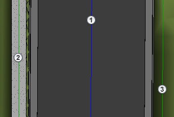

If you want a sidewalk to follow a street, use the "Create A Copy" option when creating the street. This option retains the host line for the street, making it available for reference in the model. When creating the host line for a sidewalk, you can reference the street host line, applying an offset to it.
For example, the following image shows
the host line of the street
the host line of the sidewalk, which was offset from the street host line
a host line for another sidewalk, which has not yet been placed
