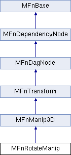

Inheritance diagram for MFnRotateManip:Public Member Functions | |
