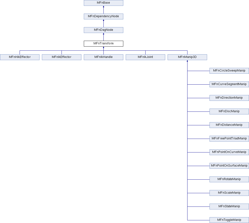

Create and access transform nodes.
The MFnTransform function set provides access to transformation DAG nodes called transforms.
DAG nodes are separated into two types, transforms and geometry nodes. All DAG nodes that are not transform nodes must exist as a child of a transform node. Only transforms provide transformation information. Transforms are also commonly used as parent nodes for the purpose of hierarchical grouping.
The transformation in the node is represented as a 4x4 transformation matrix. This function set allows access to the whole matrix, or the individual components (eg scale, rotation, shear, etc) of the transformation. The transform node is made up of many components that make up the final transformation matrix. This breakdown provides animators fine control over the animation of these parameters. Therefore, it is necessary to describe the order in which these attributes are applied to build the final matrix attribute.
