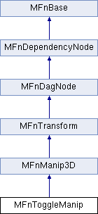

Inheritance diagram for MFnToggleManip:Public Member Functions | |
