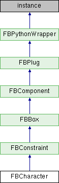

Inheritance diagram for FBCharacter:Public Member Functions | |
