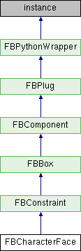

Inheritance diagram for FBCharacterFace:Public Member Functions | |
