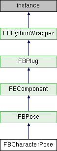

Inheritance diagram for FBCharacterPose:Public Member Functions | |
