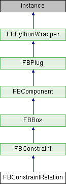

Inheritance diagram for FBConstraintRelation:Public Member Functions | |
