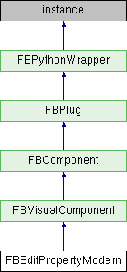

This is a more modern version of the widget FBEditProperty which is used in the property editor tool of the application. See class FBEditProperty for more details.
Inheritance diagram for FBEditPropertyModern:Public Member Functions | |
