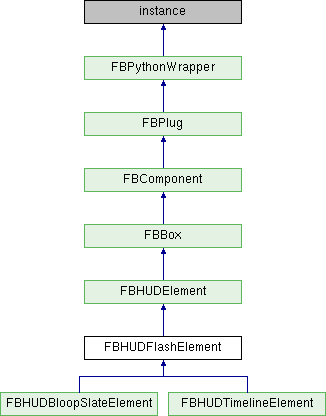

Flash HUD element. Display a flash (swf) file rendered on the HUD.
Inheritance diagram for FBHUDFlashElement:Public Member Functions | |
