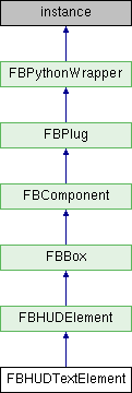

Inheritance diagram for FBHUDTextElement:Public Member Functions | |
