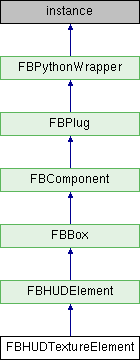

Texture HUD element. Display a texture on a rectangle on the HUD.
Inheritance diagram for FBHUDTextureElement:Public Member Functions | |
