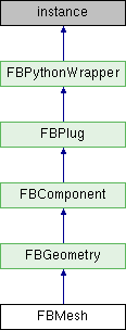

Mesh class.
Inheritance diagram for FBMesh:Public Member Functions | |
