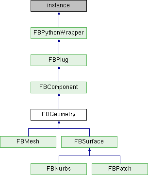

Geometry class.
This class groups all geometry related elements which are shared across the different subclasses (FBMesh, FBSurface, FBNurbs and FBPatch). Geometry Material always use kFBGeometryReference_INDEX mode. While Normal, UV could have different combination of mapping and reference modes. Geometries created with SDK can support FBGeometryMapping_ALL_SAME or kFBGeometryMapping_BY_POLYGON for material, and kFBGeometryMapping_BY_CONTROL_POINT for Normal, Tangent, Binormal, Color and UV. Only one set of UV could be supported. Geometries passed from FBXSDK pipeline could have various complex mapping/reference mode combination for material, normal and UV. And could potentially contains multiple set of UVs.
Inheritance diagram for FBGeometry:Public Member Functions | |
