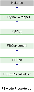

#include <mobu-python-api.h>
Wrapper around a specific instance of a FBModel object.
This class is mainly used with a constraint relation to have multiple boxes that are a representation of the same underlying model.
Inheritance diagram for FBModelPlaceHolder:Public Member Functions | |
