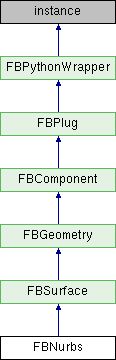

Nurbs class.
Inheritance diagram for FBNurbs:Public Member Functions | |
