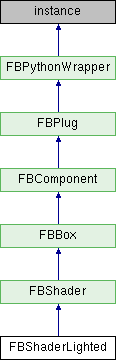

+ Inheritance diagram for FBShaderLighted:
