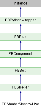

Inheritance diagram for FBShaderShadowLive:Public Member Functions | |
