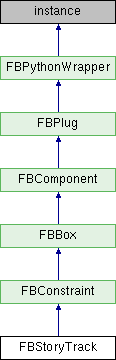

Inheritance diagram for FBStoryTrack:Public Member Functions | |
