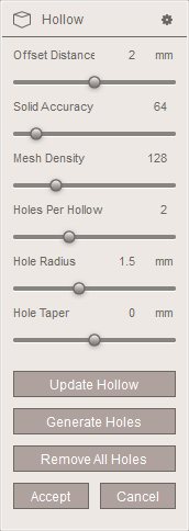

The property panel for Hollow is shown below. Like Make Solid, the Hollow tool requires that you click the Update Hollow button to recompute the internal shells. However, unlike Make Solid, we do not create a new Mesh scene object when you click Accept. Instead the new internal shells are appended to the input mesh.
The Solid Accuracy and Mesh Density sliders have the same effect as in the Make Solid tool. We strongly recommend you read up on Make Solid to understand how Hollow works.
The rest of the parameter settings are explained below.

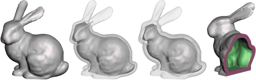

The way we compute the internal shell in Hollow is to simply run Make Solid in Accurate mode with a negative offset. So, the Offset Distance is effectively the wall thickness of the hollowed object. In the image below we Hollow with the default 2 mm, then increase to 3 mm, and finally perform a plane cut on the final object to see the shell.
Note that at both distances the bunny's ears have been filled. This is because they are less than 4 mm thick (2 x 2 mm walls = 4 mm). Also, for the 2 mm offset (middle left), you can see a few small floating shells at the base of the ear. Currently we do not automatically discard these artifacts, although if you add holes they can easily be removed.

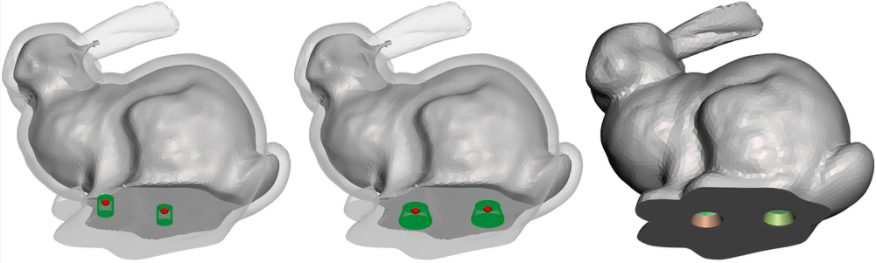

One useful capability of Hollow is that you can add "escape holes" that connect the interior and outer shell, so that if you 3D print a hollowed object, internal support material such as powder, resin, or dissolvable supports can be removed. These holes can be added automatically or manually.
To manually add an escape hole, simply left-double-click in the location you want it to be. A semi-transparent green cylinder will appear, as well as a red sphere. Left-click-drag on the red sphere to re-position the hole on the surface. Use the Hole Radius and Hole Taper sliders to control the shape of the hole-creating elements. Note that these settings cannot be performed per-hole. To discard an unwanted hole element, double-click on the red sphere. When you Accept the Hollow, we will perform a Boolean subtraction of the hole geometry. The images below show an example where we begin with two simple holes, change their position and shape, and then Accept.
You can also automatically generate a fixed number of holes, with locations determined by Meshmixer. Set the Holes Per Hollow slider to specify the number of holes for each disconnected internal cavity, then click Generate Holes. Note that we may not be able to fit the requested number of holes on very small cavities.
