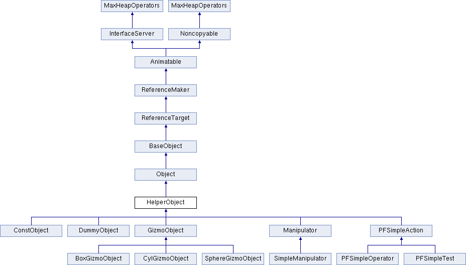

HelperObject Class Reference
#include <object.h>
Class Description
This is used as a base class to create helper object plug-ins.
It simply provides implementations for a few of the methods of Animatable and Object.
See also
Class Object, Class Animatable.
+ Inheritance diagram for HelperObject:
