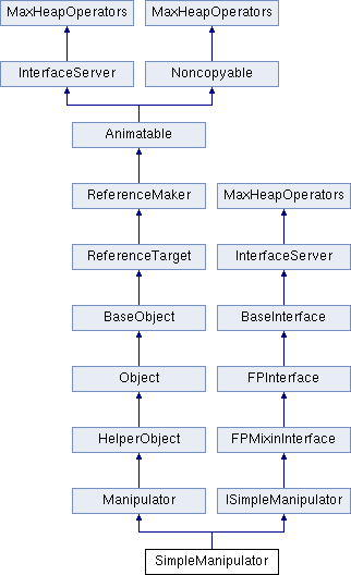

+ Inheritance diagram for SimpleManipulator:
