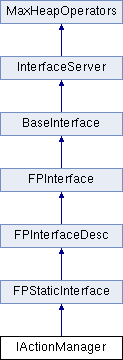

+ Inheritance diagram for IActionManager:
