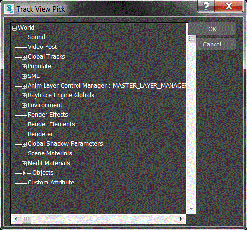

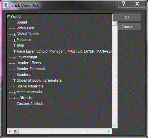

virtual BOOL TrackViewPickDlg (HWND hParent, TrackViewPick *res, TrackViewFilter *filter=NULL, DWORD pickTrackFlags=0)=0
virtual BOOL TrackViewPickMultiDlg (HWND hParent, MaxSDK::Array< TrackViewPick > *res, TrackViewFilter *filter=NULL, DWORD pickTrackFlags=0)=0

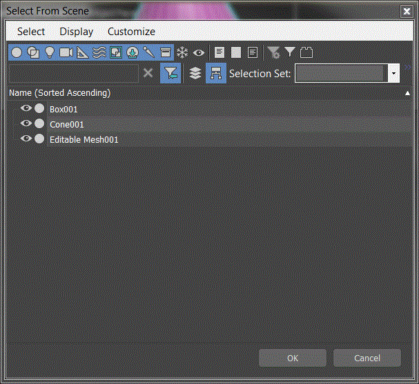

virtual BOOL DoHitByNameDialog (HitByNameDlgCallback *hbncb=NULL)=0

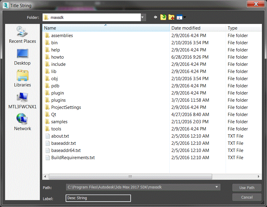

virtual void ChooseDirectory (HWND hWnd, const MCHAR *title, MCHAR *dir, MCHAR *desc=NULL)=0

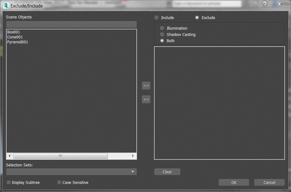

virtual int DoExclusionListDialog (ExclList *nl, BOOL doShadows=TRUE)=0
virtual void ConvertNameTabToExclList (const NameTab *nt, ExclList *excList)=0

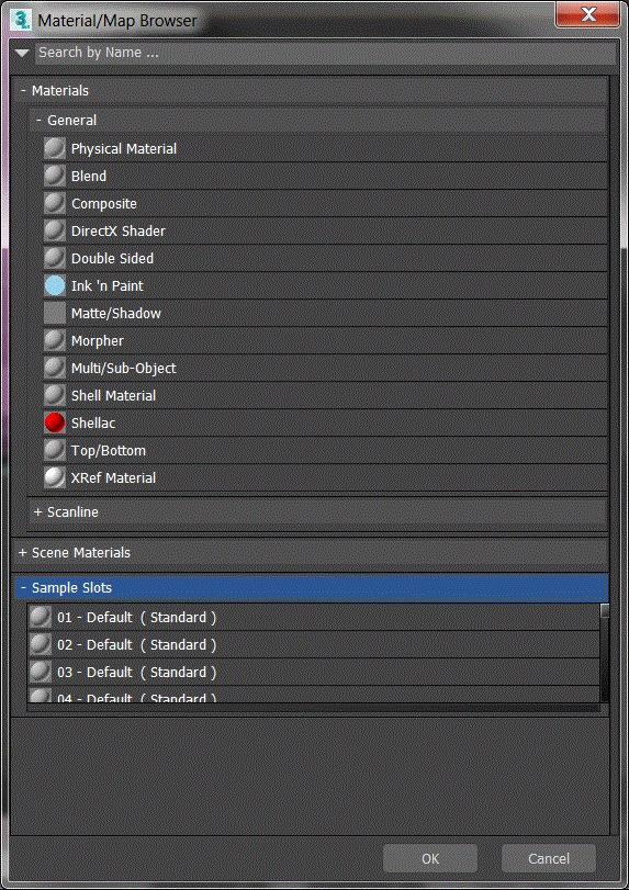

virtual MtlBaseDoMaterialBrowseDlg (HWND hParent, DWORD vflags, BOOL &newMat, BOOL &cancel)=0

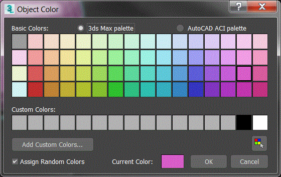

virtual BOOL NodeColorPicker (HWND hWnd, DWORD &col)=0

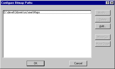

virtual int ConfigureBitmapPaths ()=0

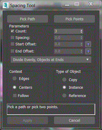

virtual BOOL DoSpaceArrayDialog (SpaceArrayCallback *sacb=NULL)=0

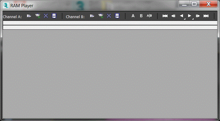

RAM Player
virtual void RAMPlayer (HWND hWndParent, const MCHAR *szChanA=NULL, const MCHAR *szChanB=NULL)=0

virtual BOOL TrackViewPickDlg ( HWND  hParent,
TrackViewPick res,
TrackViewFilter filter = NULL,
DWORD  pickTrackFlags = 0
pure virtual
Remarks
This method brings up the track view pick dialog.
Parameters:
HWND hParent
The handle of the parent window.
TrackViewPick *res
The item chosen by the user. See Class TrackViewPick
The call back object to filter selection in the track view. See Class TrackViewFilter.
See Track View Picking Flags IDs for a list of possible flags.
Returns
TRUE if the user selected OK to exit the dialog; otherwise FALSE.
Sample Code:
This code brings up the Track View Pick Dialog and filters the input to MAX's controllers. After the controller is selected GetValue() is called on it.
class MyTVFilter : public TrackViewFilter
BOOL proc(Animatable *anim, Animatable *client,int subNum) {
return (c) ? TRUE : FALSE;
void DoTest()
MyTVFilter tvf;
BOOL okay = IP->TrackViewPickDlg(IP->GetMAXHWnd(), &res, &tvf);
if (!okay) return;
Control *c = (Control *)res.anim;
SClass_ID sid = c->SuperClassID();
switch(sid) {
float r;
Interval ivalid;
c->GetValue(IP->GetTime(), &r, ivalid, method);

virtual BOOL DoHitByNameDialog ( HitByNameDlgCallback hbncb = NULL)
pure virtual
Remarks
This method is called to put up the standard MAX Hit By Name dialog.
If the callback is NULL this method does a standard select by name. The nodes chosen by the user are selected if the user selects 'Select' from the dialog to exit. Use Interface::GetSelNodeCount() and GetSelNode(i) to retrieve the results.
Parameters:
Points to the callback object. See Class HitByNameDlgCallback. Developers should delete this callback when done.
Returns
TRUE if the user selects 'Select' from the dialog; otherwise FALSE.

virtual void ChooseDirectory ( HWND  hWnd,
const MCHAR title,
MCHAR dir,
MCHAR desc = NULL
pure virtual
Remarks
This methods puts up the Choose Directory dialog box to allow the user to select a directory. The chosen directory including the drive and path is stored in dir.
Parameters:
HWND hWnd
The parent window handle.
MCHAR *title
The title in the dialog box.
MCHAR *dir
The chosen directory is stored here. This points to an empty string on cancel.
MCHAR *desc=NULL
The string to go into the Label field of the dialog. This string may be changed by the user and is returned here.

virtual BOOL AddAssetDir ( const MCHAR dir,
MaxSDK::AssetManagement::AssetType  assetType
pure virtual
Adds a permanent user path associated to a particular asset type.
Parameters
[in]dirAn absolute path
[in]assetTypeAn enumeration constant representing the asset's type
Returns
TRUE if the path was added, FALSE if not
Remarks
Remember that this function is for adding permanent user paths, not session user paths. Session user paths are temporary.
virtual BOOL AddSessionAssetDir ( const MCHAR dir,
MaxSDK::AssetManagement::AssetType  assetType,
int  update = TRUE
pure virtual
Adds a session user path associated to a particular asset type.
Parameters
[in]updatesystem configuration files with the new data
Returns
Remarks

virtual int DoExclusionListDialog ( ExclList nl,
BOOL  doShadows = TRUE
pure virtual
Remarks
This brings up the standard Exclude / Include dialog box used for light exclusion / inclusion lists.
Parameters:
ExclList *nl
If the user selects OK, this is the list of names chosen by the user. See Class ExclList.
BOOL doShadows=TRUE
The shadows switch.
Returns
Nonzero if the user selected OK to exit the dialog; otherwise 0.

virtual MtlBase* DoMaterialBrowseDlg ( HWND  hParent,
DWORD  vflags,
BOOL &  newMat,
BOOL &  cancel
pure virtual
Remarks
This method brings up the Material / Map Browser dialog box.
Parameters:
HWND hParent
DWORD vflags
See Material Browser Flags.
BOOL &newMat
TRUE if the user has selected a new item; otherwise FALSE. If TRUE it is safe to modify this item. If FALSE the item may be an instance and a developer should not modify this as other materials may be using this same item.
BOOL &cancel
TRUE if the user canceled the dialog; otherwise FALSE.
Returns
If cancel is FALSE, the item chosen by the user is returned. See Class MtlBase.

virtual BOOL NodeColorPicker ( HWND  hWnd,
DWORD &  col
pure virtual
Remarks
This method brings up the standard MAX object color picker dialog.
Parameters:
HWND hWnd
DWORD &col
If the user picks a color then this will be set to the chosen color. This is stored in a 32 bit format, with the high order 8 bits as 0's, the next 8 bits as the Blue amount, the next 8 bits as the Green amount, and the low order 8 bits as the Red amount (0x00BBGGRR). See COLORREF - DWORD Color Format.
Returns
TRUE if the user picks a color and FALSE if the user cancels the dialog.

virtual int ConfigureBitmapPaths ( )
pure virtual
Remarks
This method puts up the dialog to let the user configure the bitmap loading paths.
Returns
Nonzero on user selecting OK, zero on Cancel.
