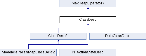

ClassDesc Class Reference
#include <plugapi.h>
Class Description
Class descriptors provide the system with information about the plug-in classes in the DLL.
The developer creates a class descriptor by deriving a class from ClassDesc2 (which derives from ClassDesc) and implementing several of its methods.
+ Inheritance diagram for ClassDesc:
Public Member Functions
