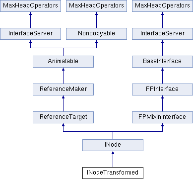

+ Inheritance diagram for INodeTransformed:
