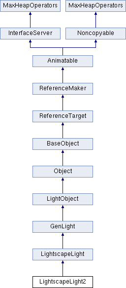

#include <lslights.h>
Extension to Photometric light This interface extends class LightscapeLight with new functionality in 3ds Max 2016.
Inheritance diagram for LightscapeLight2:Public Member Functions | |
| virtual bool | BakeWebDistribution (MaxSDK::Array< float > &bakedDistribution, size_t &bakedWidth, size_t &bakedHeight)=0 |
| Bakes a web distribution into a spherical map. More... | |
