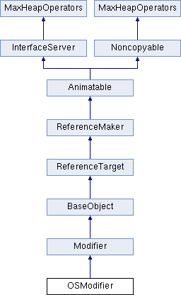

Class Description
This is a base class developers creating object space modifiers may derives their plug-ins from.
It simply provides a default implementation of SuperClassID().
See also
Class Modifier, Class SimpleMod.
+ Inheritance diagram for OSModifier:
