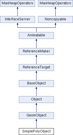

+ Inheritance diagram for SimplePolyObject:
