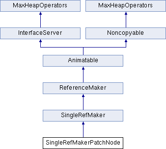

+ Inheritance diagram for SingleRefMakerPatchNode:
